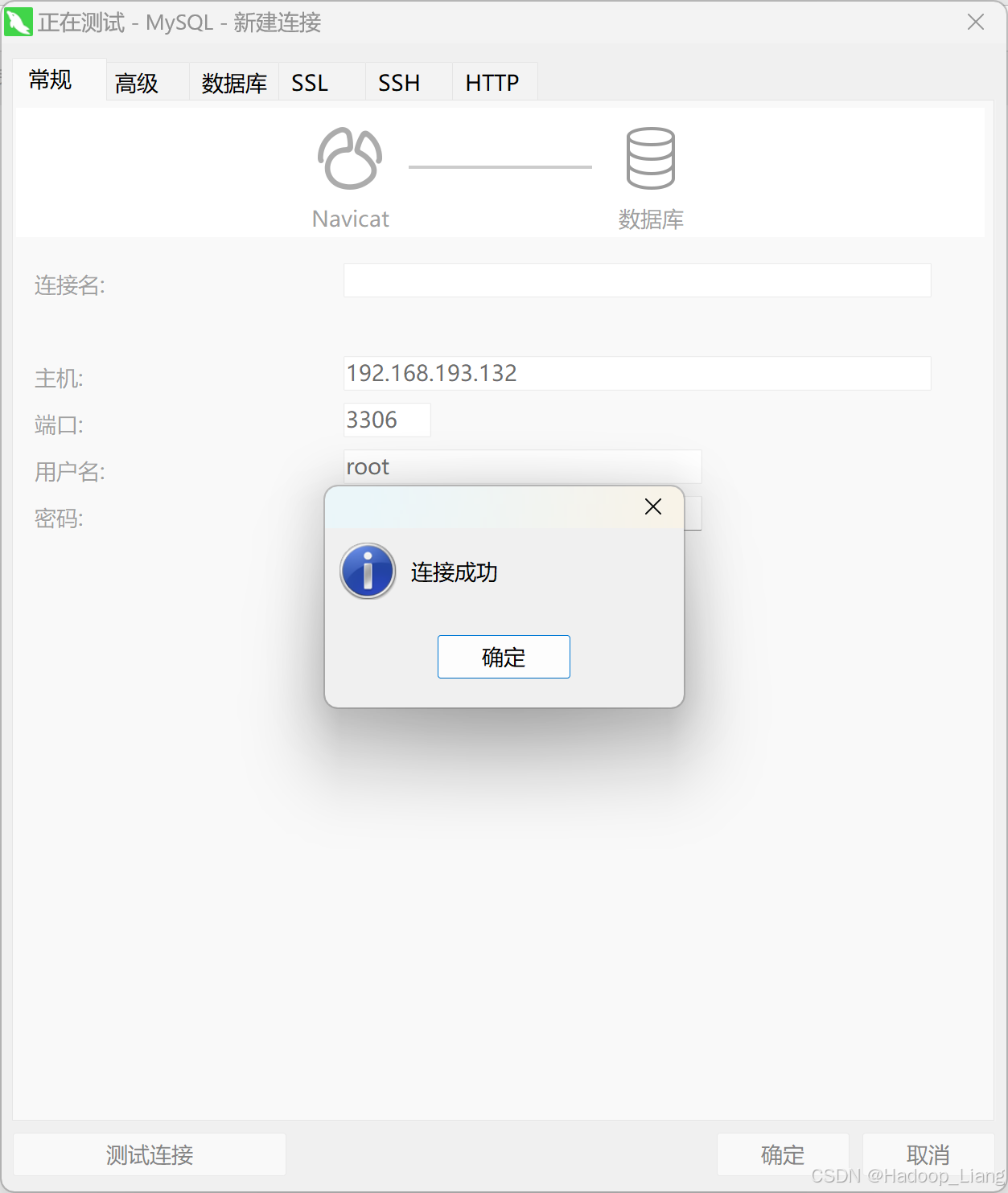

远程连接mysql
使用navicat等工具,通过ip及端口号远程连接

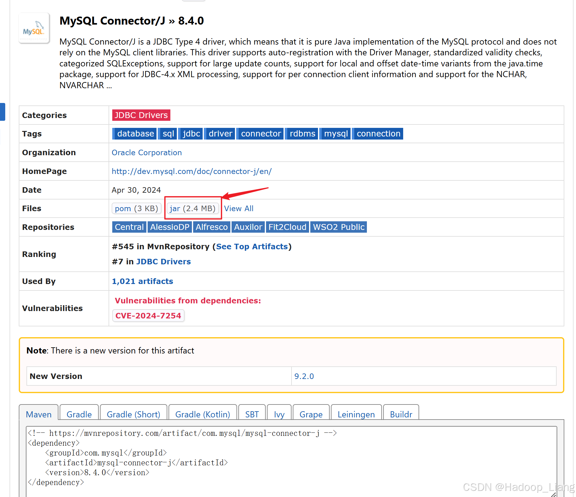

将mysql驱动拷贝到lib目次
浏览器访问如下所在,下载mysql驱动包
  1. https://mvnrepository.com/artifact/com.mysql/mysql-connector-j/8.4.0
点击jar下载,并上传jar包文件到Linux /opt/software目次
  1. [liang@node2 lib]$ ls /opt/software | grep connect
  2. mysql-connector-j-8.4.0.jar
将jar文件复制到HIVE_HOME的lib目次
  1. [liang@node2 lib]$ cp /opt/software/mysql-connector-j-8.4.0.jar $HIVE_HOME/lib/
