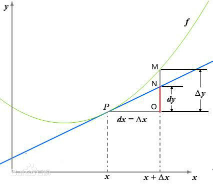

函数\(y=f(x)\)的自变量\(x\)在一点\(x_0\)上产生一个增量\(\Delta x\)时,函数输出值的增量\(\Delta y=f(x_0 + \Delta x)-f(x_0)\)与自变量增量\(\Delta x\)的比值在\(\Delta x\)趋于0时的极限\(a\)假如存在,\(a\)即为在\(x_0\)处的导数
\[f'(x) = \frac{\partial y}{\partial x} = \lim_{\Delta x \to 0} \frac{f(x + \Delta x) - f(x)}{\Delta x} = a\]
(该图来自于百度百科)

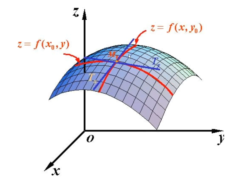

\[\frac{\partial f}{\partial y} = \lim_{\Delta y \to 0} \frac{f(x, y + \Delta y) - f(x, y)}{\Delta y}\]
(该图来自于百度百科)
高出二元的就画不出来图来了
